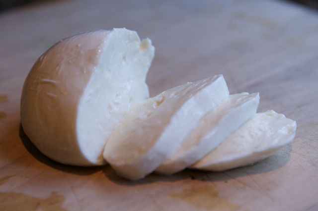

We also got an email from a viewer asking us if there was a typed recipe for the Bel Gioioso Mozzarella Curd video on our site. That got me thinking. First, I emailed Bel Gioioso and got the written recipe. Then, I found a local dealer and picked up a block of Bel Gioioso’s Mozzarella Curd and decided to watch the video on our site and make some Fresh Mozzarella Cheese!
Fresh Mozzarella Cheese Ball!
for the artisans who bring us together. We are all striving for the same thing – a better quality of life through time honored traditions of gathering, eating, and sharing.
Following is a written recipe based on the written text and the video from Bel Gioioso’s Fresh Mozzarella Curd Molding Instructions with some of my added photos.
Fresh Mozzarella:
-The curd should be stored refrigerated at 35 degrees Fahrenheit, and has a shelf life of 30 days from the date of production.
-Before starting the cheese molding process, the curd needs to be taken out of refrigeration about 3 hours before use and brought to room temperature. (Due to my enthusiasm, I made my cheese with much less time out of the refrigerator, but I can see how leaving it out would make it much easier to work with – basically getting it to the right temperature quicker.)
-To begin, cut the curd into small 1/2″ pieces using a knife or a wire cutter and place the pieces into a large bowl.
-Weigh the curd to know how much salt to add to the water. You will use 1 tablespoon of salt to 1 pound of curd.
-Place curd in a bowl. Add hot water (approx. 165 – 175 degrees), but not the salt–that comes later. Pour water down the edges of the bowl – not over the curd directly. Let the curd sit in the hot water for about 2 minutes until it softens up. Pour most of the water out – leaving the curd in the bowl. This is called the first cooking.
First Cooking – Initial warming of curd
-Add the salt (1 tablespoon to 1 pound of curd). Mix it in with the curd and remaining water.
Stretching the salted curd.
-Let the cheese sit a moment and begin stretching and turning the cheese. I used two large metal spoons to stretch and pull the cheese until it was cool enough to touch. The idea is to lift the cheese up and let it stretch down back into the bowl. Stretch until it is all even and mixed to a smooth consistency. This should take about 5 minutes.
-Mold curd into forms such as balls, logs, or braids. During this molding process, it is important to fold the curd into itself to seal it.
-Cool formed shapes by placing them into cool water. Let them cool for 10 to 15 minutes…if you can wait that long!
-After the cheese is cooled, it can be eaten or stored in a salted brine solution and should be used within a few days.
It doesn’t get any fresher than home made!
